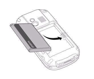

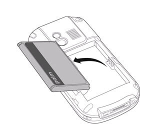

  3. Slide the battery cover downward to remove.
  4. Remove the battery.
  5. Re-insert the battery.
  6. Replace the battery cover by sliding upward.
